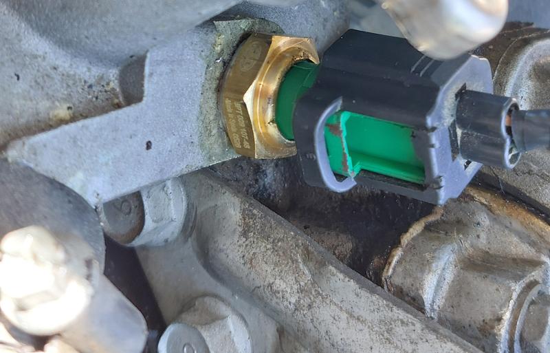

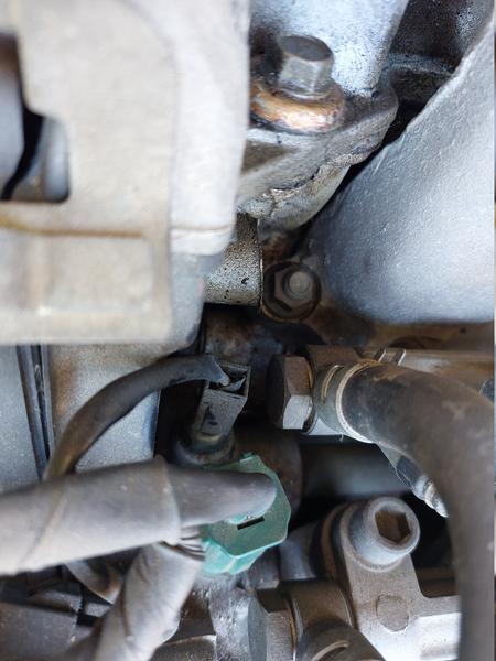

Beitragvon JokeCro » Mo 8. Jun 2026, 19:29
There are two more sensors in that location, one with one wire (for the needle on the dashboard) and another with two wires.
What is that second sensor actually for?
I put a new one on the third one.
Zuletzt geändert von JokeCro am Mo 8. Jun 2026, 19:40, insgesamt 1-mal geändert.

Beitragvon JokeCro » Mo 8. Jun 2026, 19:34

New ECT coolant sensor installed.
I also replaced the first relay that was cracked with a second new relay.

Beitragvon JokeCro » Mo 8. Jun 2026, 19:38

Yes, there are actually 3 different sensors in that location, one with a single wire (probably for the needle on the dashboard) and two sensors on each side near the coolant cap.
I replaced one, the green ECT one.
